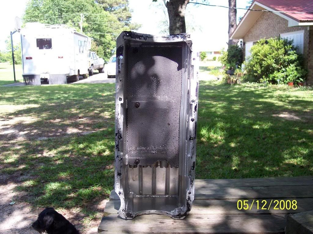

I've got one of those high dollar pans and titan pump for sale for a genIV blk. it wouldn't fit our door car with a cross member. About 1300.00 worth for 600.00 if you or anyone else is intrested, PM me.
Zip.
http://img.photobucket.com/albums/v5...2/100_0672.jpg
http://img.photobucket.com/albums/v5...2/100_0669.jpg
http://img.photobucket.com/albums/v5...100_0667-1.jpg
