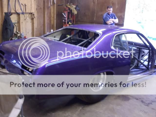

First things first, I have a 70 Duster that I am putting together and will be using a BBC and I have a glide I want to use. I need to measure to see which I have, 1.76 or 1.8, but I want to switch to a turbo shaft because I have a converter for it and its better from what I hvae read on here. What is the best combination I have, the motor is a 454 nothing special but I want to build the trans the way I want it the first time. What is a stock case good to HP wise? anyother suggestions for the valve body brand? dont plan on using a transbrake, also need a good source for parts.
Thanks Jason [img]http://i884.photobucket.com/albums/a...er11302009.jpg[/img] |

Why that's BLASPHEMY !! and just plain WRONG........ :shock: :shock: :shock: :shock: In all fairness, it looks like a fun project,especially the MOPAR BODY and COLOR :D :D :D |
