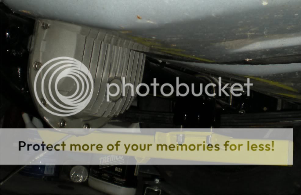

Originally Posted by PxTx
Check out the right side slapper and how much it is bowed under the torque loads on it at the time of launch !! :shock: :shock:

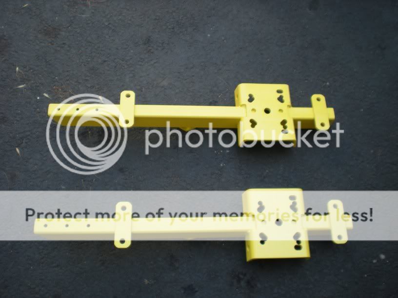

This is what is on the car right now (kinda). It is an old school, "long tail" bar as I call them, but what you are saying about preventing spring wrap s a good idea.
I've got a set of these too, but neither of them touch the spring eye the way I want it to.

Someone used to make tapered spacers that went between the spring and the bar to adj the angle of the bar.They were to adj pinion angle when used on top of the spring.But You could use them under the spring to adj.the bar angle.Bill.

Lakewood still does.
